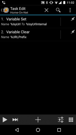

Now, let's create the first task, step by step: (CaSe is important)
Click the 'Tasks' tab (top of screen)
Click + (bottom right of screen)
Set the task name to 'Home-On-Net' and touch the check-mark
Click the + bottom center of screen
In the 'Filter', type 'variable. Scroll and select 'Variable Set'
In the 'Name' box, type '%IsyUrl'
In to 'To' box, type '%IsyUrlInternal'
Hit 'Back' (gear icon in the top-left of screen)
In the 'Filter', type 'variable. Scroll and select 'Variable Clear'
In the 'Name' box, type '%URLPrefix'
Hit 'Back' again (gear icon in the top-left of screen) to return to the list of tasks..
