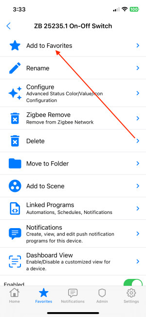

Click the settings icon from the Node's Dashboard.
Click Add to Favorites

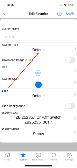

Click Favorite Type
Select "Custom Tile"
Add https://javierrefuerzo.github.io/example-tile?height=180&span=3.html as the URL for the Custom Tile.
