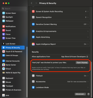

- If you are prompted, be prompted with a dialog warning you that you cannot open this application:
On older Macs-
- Go to System Preferences | Security & Privacy | General
- Scroll down to the bottom
- Click on the open anyway button at the bottom
Then try Start.jnlp again.
On newer Macs-
- Go to System Settings | Privacy and Security
- Click on the open anyway button at the bottom (**Sequoia users scroll down and look for something that says Mac OS has blocked an app from running. Click there and allow the app)
Troubleshooting: https://wiki.universal-devices.com/Main_Page#Unidentified_Developer_Blocked
If that does not work, try right-clicking on the start.jnlp and choosing open from the drop-down menu.

Another security measure may stop you from loading start. In that case, go to System Settings/Privacy and Security.
In that case,
- In that case, look for something that says Mac OS has blocked an app from running.
- Click to allow the app.

Unidentified Developer Blocked
If finder does not open on Mac it may be blocked by your security settings. The following dialog is only shown once, and you only have a limited amount of time to allow this file. If the time frame to allow this file has passed the user may need to uninstall then reinstall Finder in order for "Allow" to be shown again.
Go to Apple (top right) > System Setting (sometime call preferences) > Security & Privacy. Security & Privacy preferences may require your Mac Admin Password, or you may need to click the Lock at the bottom right to allow editing. You should see a security warning for start.jnlp (note the image below has start (2).jnlp as there were multiple downloads). Click "Open Anyway"
A developer warning may be presented, click "Open"
